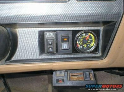

I know people who tune sensors by using that wellsmfgcorp test and installing the vac gauge in-dash
(as Steve83 did)
with a scope/or freq counting w/display MM mtd in a console
