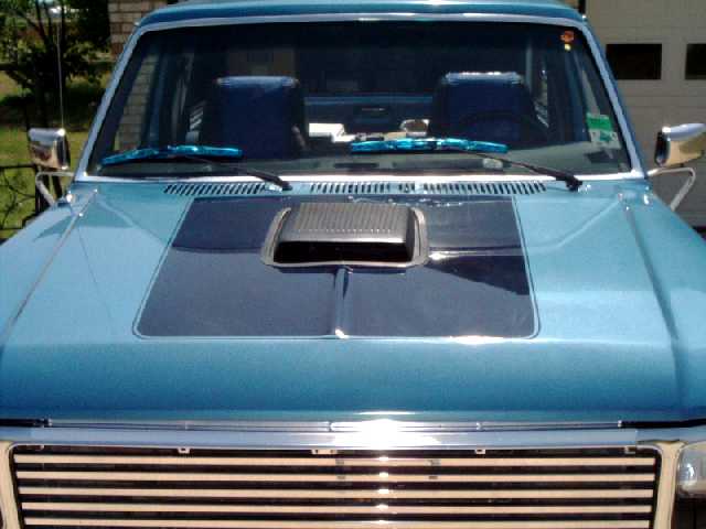

Most of the aftermarket hoods with a cowl or other scoop molded in will be fiberglass. Companies like US Body Source and Unlimited Products have the hoods as well as just the scoops in various styles. These scoops can be bolted, riveted or glued onto the steel hood, then molded in with body filler for a clean look. This is the cheaper way to go, since the scoops run about $100 vs $500-$600 for a complete hood. You can also do what I did on my 84 and cut an opening in the steel hood to make your scoop functional or add clearance for a taller air cleaner. As long as you do not cut into the rear support rib there's little to no affect on hood strength, JSM84
http://www.supermotors.net/getfile/70368/fullsize/shkrhood4.jpg
http://www.supermotors.net/getfile/74416/fullsize/thwbronco14.jpg
Many of the hood scoops I looked at before going with the Shaker style were very wide. Some were as wide as the dark blue stripe on the hood, others even more from ridge to ridge (54-55 inches).
