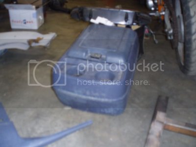

ive got some 89 bronco seats that will bolt right in for you:)
guy i work with put taurus seats in his f150. i dont know if they bolted right in or not though, i think he said they did. What do you do with your truck? i know summit has some decent seats that are a good price.
But if you are close/ can pick up what i have, you can have all 3 for $100.
bottom of this page and page 3 are pics
http://s268.photobucket.com/albums/jj39/sh...0Sale/?start=20
oh and ps, ill throw in the center console that bolts into the truck too:)
sorry its a blurry pic

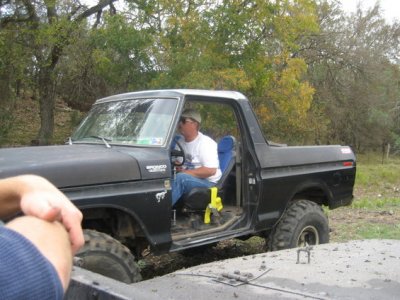

sketts. i am 110% sold on the racing suspension seats over any others. Instead of a rigid frame covered with foam, these style seats have parachute cords stretched across the middle, so you feel like floating on air not sitting on a bucket. Some brands are Beard, MAsterCraft, and PRP Racing. I recentlt mounted a pair of PRP seats in the 78 Bronco that I bought for the 84 a few years ago. I did have them bolted up to the 84 bucket seat frames while i was building the rollcage, and made mounting tabs on the cage to bolt the seats to. The mounting tabs on the PRP seats point down vs being flat on the MC and Beard's. I just fabbed some angle iron mounts for the 84 bucket brackets, and welded a few tabs to a bench seat frame for the 78 Bronco. You can check out the PRP Racing website for a direct-fit seat bracket.
Just an important note: Anytime you mount aftermarket seats to the stock bucket seat frames, check the passenger-side for clearnace with the windshield when the seat is flipped forward. My PRP's were OK, but I've seen a few busted windshields on other Broncos, JSM84

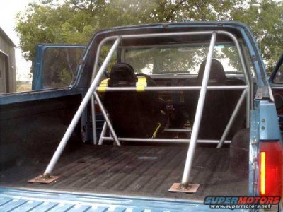

I would ONLY use a 4-pt or 5-pt harness if you have a seat bar or rollcage to mount the shoulder straps to, level with your chest. It is NOT safe to mount them to the floor, as that can cause your spine to compress from the straps pulling downward. On the 78 Bronco, I am only using the lap belts and the submarine belt, all bolted to the seat frame. Here's a shot of the same seats mounted in the 84 Bronco, with the shoulder harnesses mounted to the horizontal seat bar:
The RJS 5-pt harnesses I'm using have a quick-release lever, which I prefer over the stock seatbelts and the pushbutton latch.
