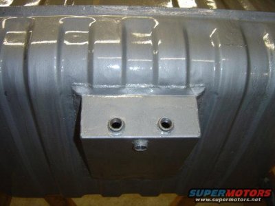

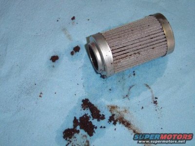

I was having some problem's with the new fuel system I installed in the Bronco about 6 month's ago.Burned up my new Aeromotive pump.Come to find out, the sump I had my friend weld in the tank was not sealed and it started to rust so it screwed up my pump.Now I'm sealing the tank the right way and should get it back together soon.Here's some pick's of the rust I had. That's only 6 month's worth of rust.

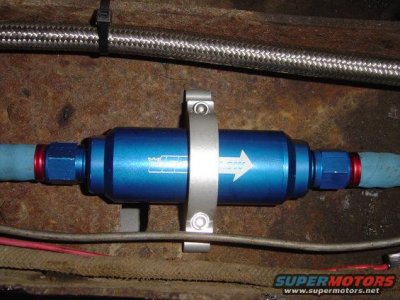

Added a new fiter as well.I have a 100 micron before the pump and a 10 micron after it.

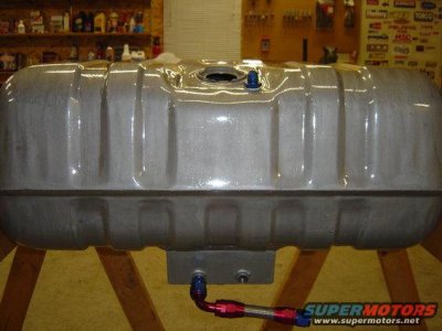

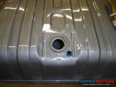

The tank is almost ready to be installed,the outside had been sealed.Now I'm waiting for the inside to cure.

Yeah fighting rust in the fuel tank always seems to be a big fight!! Looks like you are ready for battle know. Looks real good!
