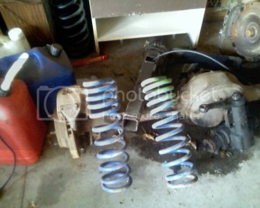

Hey a Friend is going to give me some lifted f100 Coil springs for my bronco will they fit without any modification?
Any response willl be appreciated.

You should measure the height of the coils and call one of the parts warehouses. They will be able to tell you for sure if they can be used. The springs might be thicker steel and therefore, not useable because the spring retainers can't hold them in place. But call the EB vendors before you tear it apart.

ok thanks I got the 32"s to fit already but I'll do some measureing and call around to find out
thanks

not guna work bro the F100 was a two wheel drive with the swing arm setup that means they were held in by 1 big ass bolt from the bottom.... u might b able to cut them to work though??

K i'll look at em' and see what i can do and what other options i have cause i really wnat to lift it a lil

then again the bargin lifts from the "bronco only guys" are just as cheap.. turns out this is 1 of them times you get what you pay for "and even in my case what you dont pay 4" like i told you in that pm lime green basicly all these or any cheap coils are really is stock or leveling coils for a f150....they do lift the truck.. but there stiff and dont flex well

K i was looking at purchasing superflex coils from bronco graveyard, wither the 3.5 or 4.5 since i have a the HD option on my Bronco I'd rather have it bulldoging than sittin higher in the back then putting either 2 or 3" blocks on the back or depending on cash gettin all new lifted leafs
how high can i go in the fron and rear without gettin new drive shafts?

depends, are you going to use it off road? if not you can go 2 1/2 without messing with them. if you plan on flexing the suspension at all its always good insurance to lengthen them.
