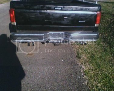

it was $350 for dual glasspaks on my 87 f150, in my opinion they sounded amazing, the tips on the back were $25ea so around $300 from my hometown Scottsboro, AL
and by the way it had no exhaust when i bought it, just straight headers
miss that truck :S
