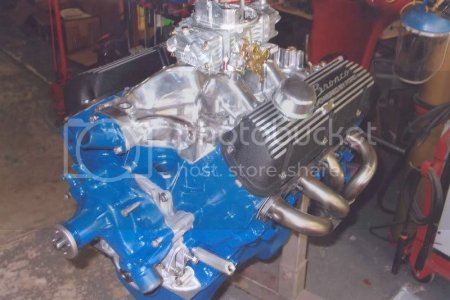

Hi guys I have a 79 Bronco that I'm putting a rebuilt engine in. I need to know what color to paint it first. Thanks
Go to your local speed shop or autoparts store where they sell hi-temp engine paint. What you want will usually be labled "Dark Ford Blue", "Grabber Blue" is also a good alternative if you spot that instead. Paint shops (such as your local PPG store) will also have it available.
Using a Hi-temp primer isn't a bad idea either, just be carefull to not put too many coats onto the heads, they get very hot especially around the exhaust ports, if you lay the paint & primer on too thickly it will peel up. Either way don't expect the paint arount the exhaust ports to look good for very long, there isn't much you can do about that area short of powdercoating the whole head or going with an aluminum one. Keep it down to a single coat of primer & just enough color to make it look nice. The rest of the engine shouldn't present any problems, the exhaust ports are the only real hassle.

Engine paint: how about heat dissipating paint, few different companies produce it. The tin should be Ford blue.
