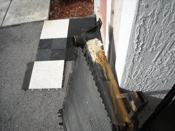

Since it's in your 83 and am guessing you didn't buy it new; rad may have the plastic end caps; these leak, on my 96, overnight when engine is cooling down. I too never smelled the coolant aroma inside (heater core leak) or outside; even after and when it is running and never in the morning; never saw the leak until that magic moment on the coldest day of the year when it went completely South and the coolant looked like the Falls (Canadian side, of course!)
I would only see signs of the leak(s) on passenger side radiator core support/frame where it is "boxed in"... Driver side isn't boxed in at bottom so the end cap leak would drain off and evaporate quickly.
here is a pic of such a leak on a rad by Bill;
http://www.supermotors.net/getfile/773825/fullsize/picture-021.jpg
a prev owner attempted to repair it w/JB Weld
