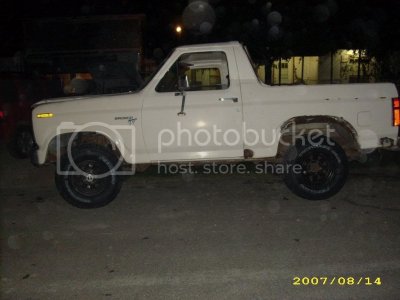

I recently Got a holley 500 and put it on my 81 bronco with a 351 m and i was wonder if they make a throttle kit and trans kit for the kick down it has an auto trans
and my fender wells have some cancer and i was wonder if anyone knows where i can find some fender flares
heres a pic of the bronco
Ok, here are the short answers to your questions.
*** ? Yes and here, take a look: http://www.truckaddons.com/Catalog/subpage...fenderflare.htm
Really don't know what you mean by throttle kit but explain further & I'll look.
Tranny kick-downs are available from Holley & any of the major online speed shops
Bushwacker flares will allow you to cut out that cancer AND run bigger tires without a lift kit (but if you run a lift kit you can run even BIGGER tires, it's a great upwards spiral)
P.S. if you want you can cut out that hole behind the door & poke your exhaust out thru it for a killer look and also tuck it up & out of the way.

By the way, that truck has the same cancer mine had. Actually the same as 99% of the NE Broncos have. It is actually a designed in flaw that Ford put in to sell more Broncos. Check out the gap in the rear wheel well mud guard,(more appropriately called mud collectors, if you ask me), what a stupid design. It allows the tires to fill the B post up with mud and salt which sets there and slowly eats it's way out. The same for the rear end of the quarter panel. I redesigned mine, after doing the body, work to fix those areas so the mud guard seals up against the quarter panel. Made mine from 18 wheeler mud flaps, a little stiff, but workable.
