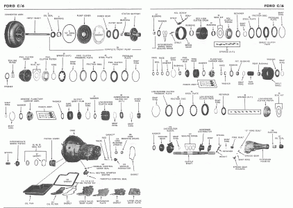

Yo diy,
/monthly_03_2017/post-3816-0-12302400-1489503194.png
/monthly_03_2017/post-3816-0-59769500-1489503177.png
Vacuum Modulator on passenger side of transmission; Check for vacuum at mod. Should be around 16 - 21 psi in idle.
Pull vac line off,if there is a flow of trans fluid, replace modulator.
Low fluid level
Shift linkage;Purl="http://web.archive.org/web/20101224143958/http://ylobronc.users.superford.org/documents/linkage3.gif"]http://web.archive.org/web/20101224143958/http://ylobronc.users.superford.org/documents/linkage3.gif[/url]"
Parts Break-Out Diagram in an 88 with nomenclature @  http://web.archive.org/web/20051229052026/http://ylobronc.users.superford.org/documents/linkage3.gif">http://web.archive.org/web/20051229052026/http://ylobronc.users.superford.org/documents/linkage3.gif
by Dustin S (Dustball, Mellow Yellow, Mr. Laser Boy
 Vacuum Modulator Replacement in an 89; "..The different color bands indicate the diameter of the rubber diaphragm inside the modulator. The two COMMON colors from auto parts suppliers are PURPLE and GREEN. These are for CARS. TRUCKS like OURS REQUIRE the BLACK banded modulator, likely from a transmission shop or dealer. This is regarding the mid/late 80's models, maybe more... Id venture to say any C6 with a slip in modulator. Again, PURPLE and GREEN are NOT the correct units to use, BLACK is the intended modulator as was designed for TRUCKS; by MyFullSize (Andrew)
Or Clogged filter.
Yo, part deux,
NOTE: If automatic transmission fluid is present in the vacuum side of the vacuum modulator  or in the vacuum hose, the vacuum modulator's diaphragm is leaking and must be replaced. by Ford
C6 Description & Operation, Adjustments, Diagnosis & Testing (partial), Disassembly & Assembly, Parts Break-Out Diagram, Hydraulic Control System Diagram, Removal & Installation & Specifications @
http://web.archive.org/web/20090529064029/http://www.thedieselfiles.com/Ford/C6%20Automatic%20tranny.pdf

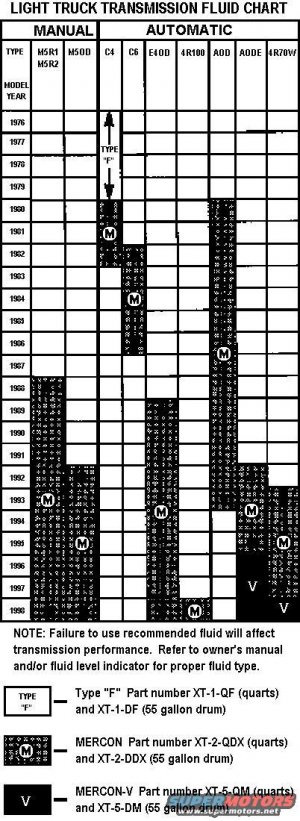

what does this take, just off the shelf ATF?
The C-6 also has a very large fluid capacity at 24 pints, including the fluid in the torque converter. Ford used type FA transmission fluid, which was specific to Ford transmissions until mid-1977 when C-6 transmissions were converted to Dexron/Mercon late in that model year. The easiest way to tell what fluid you should be using is to check the dipstick. The stick will reference either the FA specified fluid or an M2C138-CJ specification, which is Ford's designation for Dexron/Mercon.

i checked with the guy that rebuild the tranny last year, he said merc/dexron so i added about 3 quarts of that and all seems well
ill let het settle for a while and check again next time i take her out
