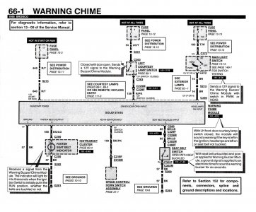

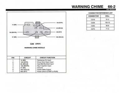

See these chime wiring diagrams in a 95 by Seattle FSB
Unplug the chime connector, release the terminal(s) of the function you want to disable, tape it(them) back to the harness, & re-connect the chime.
Key in [URL="http://rover.ebay.com/rover/13/0/19/DealFrame/DealFrame.cmp?bm=367&BEFID=96424&acode=349&code=349&aon=&crawler_id=208580983&dealId=t2DZNHMoJEUDelfVrOaWEA%3D%3D&searchID=&url=https%3A%2F%2Fautoplicity.com%2F9178729-nachman-sm-01112-ignition-coil-polaris%3Futm_source%3DShoppingCom%26utm_medium%3DCSE%26utm_campaign%3DShoppingComNOFITMENT&DealName=Nachman%20Sm-01112%20Ignition%20Coil%20Polaris&MerchantID=507376&HasLink=yes&category=0&AR=-1&NG=1&GR=1&ND=1&PN=1&RR=-1&ST=&MN=msnFeed&FPT=SDCF&NDS=1&NMS=1&NDP=1&MRS=&PD=0&brnId=2455&lnkId=8070676&Issdt=170519050504&IsFtr=0&IsSmart=0&dlprc=28.13&SKU=9178729"]ignition = Bk/Pk
Parking lights = Br
Driver's door = R/Pk
Driver's belt = Br/LB
Door jamb pin switcswitch may be stuck closclosed or door hinges are worn
If the key buzzer/chime is always on (even when the key is out & the cylinder bezel is properly aligned), then the contact has probably come loose from the steering column, and is grounding against it (1). With the cylinder assembly & column shroud removed, the contact belongs fully in the channel under the cylinder with its upper tab hooked over the column's debossment (2). The tab commonly breaks, but even if it's intact, it's a weak retention method which can be improved easily by the addition of a zip-tie (3). Ensure the contact touches the switch on the cylinder when the cylinder is inserted (4). Finally, ensure the zip-tie does not interfere with the column shroud (5).
The lock cylinder catch pin (6) is accessible through a small hole (noticeably smaller than the ***** holes) in the bottom of the column shroud.
See the NEXT several pics & captions for lock cylinder repair...@ http://www.supermotors.net/registry/media/1045646

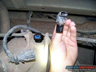

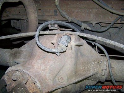

Found the code to be a 452, which google tells me is insufficient input from vehicle speed sensor.  I have read a little about them on the rear diff of the bronco and hoping it is something simple.  hopefully i will have time today or tomorrow to look into it.   Thanks again for all your help
Yo,
VSS Location pic on a 95 on rear differential (8.8)
 figured there wern't alot of pics of this on here, and I just did it tonight, so here ya go.
this is with the old one out and the new one in.
The other night, it started to shift way late and jolt really bad. Speedo and odometer stopped working and the overdrive "off" light on the shift lever started blinking. I tried just taking the sensor out and cleaning it off. That didn't work so a quick run down to the parts store and $15 later, back to normal.
Source: by Broncodell
Inspect the VSS, it's connector and wiring for damage, corrosion, etc.  Measure resistance between pins.  Should be 800 to 1,400 ohms and  10 ohms between metal shell and either pin.
Keep it even if you purchase a new one because some aftermarket pieces have wroung resistance among other issues.

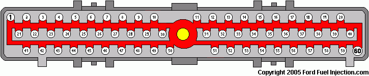

instead of breakout box, go to the EEC CONNECTOR pin or other instead; for instance - Measure resistance between Test Pin 3 and Test Pin 6; EEC Connector Pin 3 is VSS +
in 6 is VSS -
To help troubleshoot;
EEC IV Connector Pin Diagram
by Fireguy50 (Ryan M)
EEC Connector Pin Outs LEGEND, Bronco & Ford Truck & Van: 4.9, 460, 5.0, 5.8; by Ryan M (Fireguy50) @ http://web.archive.org/web/20120118104425/http://www.oldfuelinjection.com/truckpinouts.html
