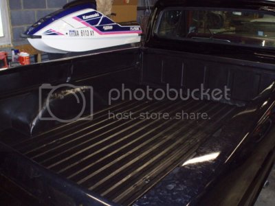

Silver Bullet stuff is supposed to be good for sound. two weekends ago i just did the duplicolor roll on bedliner on a 70 f100 i restored and it wasnt too bad of a job.
