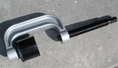

The first time i did them on my truck i was working at an auto garage and i paid the mechanic to do it(with me helping) because he had the tools. I think i ended up paying him $90 plus parts. It was awhile ago. Its really not bad if you have a press or a ball joint tool and an impact wrench. The tool can be rented from most places(or purchased for less than a mechanic would charge, really just a big C clamp with pockets). the air tool isnt necessary but is very helpful. With no air tools you better have a vice to clamp the spindle in. I would expect to pay 2-3hrs labor. I dont know which setup you have. i think mine were integrated into the spindle but i remember having fun beating it with a hammer to unseat the tapered part.

When doing your ball joints yes you do need to remove the caliper, rotor/hub assembly and slide the axle out after you unbolt the bearing race/spindle. If youve done that before and have all the tools your more then half way there. With the axle out you can gain access to the inner castle nut. once both are loose you take a big hammer and whack it till your assembly is loose. from there its just a matter of having/using the ball joint tool.
