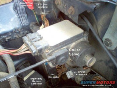

and here is da ign diagram for a F 150 but similar
http://fordfuelinjection.com/files/bronco_1995_21-1.gif by Ryan M
SPOUT is shown in upper left
check both Pink wires from SPOUT for short; one wire goes to Ignition Module (pic below)
other goes thru shielding (poss short to ground location) to PCM pin 36
Ignition Control Module (ICM) Location pics (near driver's side hood hinge) & info in a 96 5.8; "...Spout connector wires go into ignition module wiring connector..."
Source: by DNBELOWBRONCO (Kevin, Labor of Love) at SuperMotors.net
