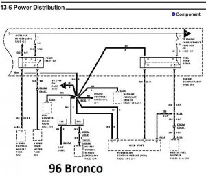

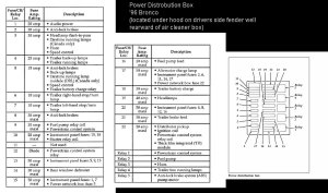

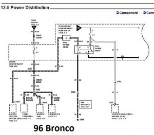

I have vision issues, I believe thses are for **** fuse 9 in PDB; disconnect the PCM Power Relay just to see if that keeps from blowing the fuse.
Same test for PCM and Fuel Pump Relay
Then a grueling similar test for everything that is fed by circuit 361 Red.
Heat related perpetrators could be fuel pump relay coil corroded contacts; same for PCM.
