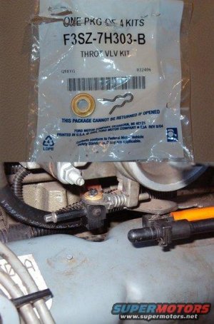

TV Brass Bushing "...are known to have problems with TV cable adjustment, and it's often due to the original rubber bushing cracking & falling out while driving, which normally destroys the transmission in a couple of miles. But it's so common that Ford makes this upgraded brass bushing (see pic for Ford part number), which is cheap (~$10) & easy to install..."
