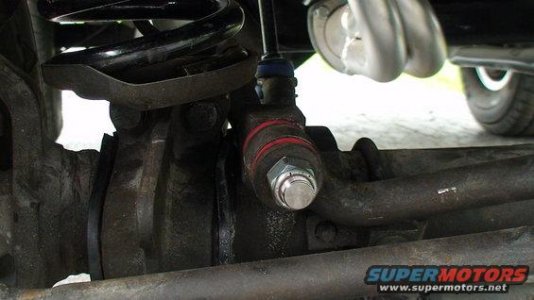

Check that axle hole good where the track bar mounts. You might want to consider putting the tapered bolt in the axle as well as it takes out all possibilities of movement. You have tilt wheel? Does the steering shaft from column to gear box stay in one spot and the steering wheel move 2" or does the steering shaft move right away while turning the wheel?
Here is a pic of the tapered track bar bolt fix.
"PROBLEM NOT FIXED"
Thanks for the pic. I was wrong, my wheels still shake very bad when I get on the street at speeds over 35 or 40.The axle hole doesn't seem to be worn or out of wack. When turning the wheel the slack and movement looks like it is all in the bushing on the drivers side. For instance, when I turn the wheel the frame shifts about a half inch or so from side to side depending on which way I turn the wheel, and as I watch it, the bushing is giving slightly( i guess cuz its rubber?) but only on the drivers side. But all other front end components seem to be all tight and in good shape. I do have one question though. My track bar has a slight bend in it by the front differential. Is it supposed to be that way or not? Currently I have a solid track bar. Do you think if I got an adjustable track bar that would make a difference? Please help...

I thought you just replaced those bushings? The body should not move at all when turning the wheel. Replace those bushings with some good ones and it should clear up your problem. I would also double check the axle mount end to for any play. Another problem is frame cracking where the gear box mounts. It is a little rarer on most but does happen. The track bar does have a slight bend from the factory and that is normal. An adjustable track bar won't solve your problem.
