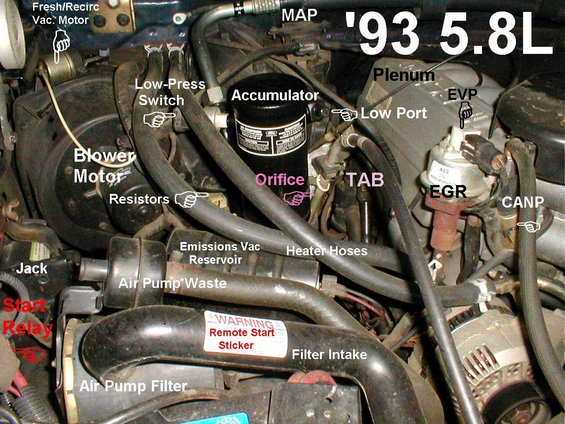

Operational Description; This pumps fresh air into the exhaust system, to burn left over hydrocarbons, lowering emissions. The computer uses 2 air valves (TAB & TAD) to control where the air flows depending on engine operation. Thermactor Air Bypass (TAB) shunts air to the atmosphere, when no air is needed. When air is needed it sends air to the second valve TAD. Thermactor Air Diverter (TAD) diverts air either to the exhaust manifold, or directly to catalytic converter. MIESK5 NOTE; If da Engine Coolant Temperature Sensor (ECT) is Below 50 degrees F, then TAB is grounded & sends air to atmosphere; If Between 50 and 190 Degrees F, Bypass Valve sends air to Diverter and to Manifold; If Over 190 Degrees F, it is in closed loop & Air goes to Catalytic Converter; Bypass when at idle/Wide Open Throttle (WOT), and with failing Oxygen Sensor. The fastest way to see if vehicle is in open loop is to see where the air is going; to Catalytic Converter, it is in Closed Loop; to Atmosphere or Manifold it is in Closed Loop, provided the thermactor system is working
Filter & Silencer Location Depiction & Pic
http://www.supermotors.net/getfile/252396/fullsize/secondaryair50l.jpg
and
http://www.supermotors.net/getfile/148977/fullsize/5.8l-right.jpg
