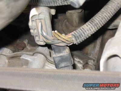

Wiring:
Always check your wiring.  Here is a picture of SPOUT (Spark Output signal) wire that was grounding out.
The yellow spark output signal wire is without a section of insulation. This section happens to run through a shield ground that provided a convenient ground source for the SPOUT signal. Just the right bump in the road or vibration from the engine would provide a path of lesser resistance for the SPOUT signal, killing the coil trigger.
SPOUT Connector pic in an 88 5.0
by jem270
BTW, the SPOUT connector is pulled out when timing the engine.
This is where the TFI Modile plugs in to the distributor to get the PIP signal.  Notice the defective insulation.
