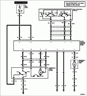

Refer to the following electrical schematics when performing diagnostic pinpoint tests.
Interval Wiper, Washer Circuit — Except F-53 Motorhome

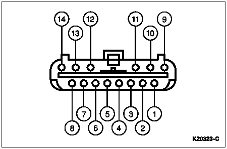

Pin Number Circuit Circuit Function 1 589 (O) Multi-Function Switch Mode 2 65 (DG) Ignition Power (Hot in ACC or RUN) 3 57 (BK) Ground Circuit 4 941 (BK/W) Windshield Washer Pump Motor Feed 5 57 (BK) Ground Circuit 6 — Not Used 7 993 (BR/W) Multi-Function Switch (Common) 8 56 (DB/O) Wiper Motor LO Speed 9 590 (DB/W) Multi-Function Switch (Internal Mode) 10 61 (Y/R) Wiper Motor (Common) 11 65 (DG) Ignition Power (Hot in ACC or RUN) 12 — Not Used 13 28 (BK/PK) Wiper Motor Park Switch 14 58 (W) Wiper Motor HI Turn Signal and Windshield Wiper Switch Connector

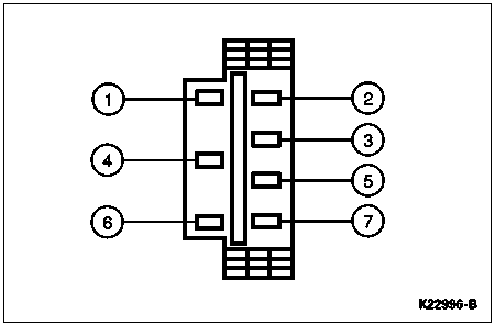

miesk5 Note, Ford tries to cconfuse us owners by referring to the turn signal as the [SIZE=23.9997px]Multi-Function Switch (MFS) depending on how they wake up each morning.[/SIZE]
Pin Number Circuit Circuit Function 1 589 (O) Multi-Function Switch Mode 2 15 (R/Y) Headlamp Dimmer Switch Feed 3 13 (R/BK) Headlamp Dimmer Switch to Low Beams 4 993 (BR/W) Multi-Function Switch (Common) 5 12 (LG/BK) Headlamp Dimmer Switch to High Beams 6 590 (DB/W) Multi-Function Switch (Internal Mode) 7 196 (DB/O) Instrument Panel Lamps Feed

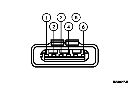

Wiper Motor Connector
Pin Number Circuit Circuit Function 1 57 (BK) Ground Circuit 2 28 (BK/PK) Wiper Motor Park Switch 3 65 (DG) Wiper Motor Power (Park Feed) 4 61 (Y/R) Wiper Motor Common (Run) 5 56 (DB/O) Windshield Wiper Motor LO Speed 6 58 (W) Windshield Wiper Motor HI Speed
