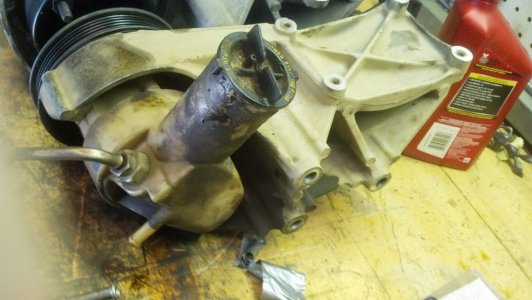

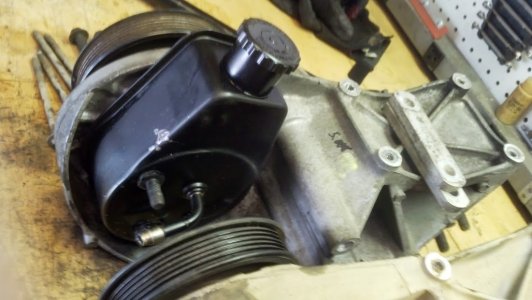

Here are pictures of the stock pump and bracket and the Saginaw (all black pump). It looks like the curve in the bracket around the pump will cause issues.
