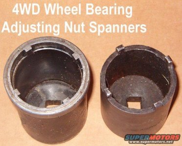

re; "... purchased the 4 prong 2 1/2 in lockring socket..."
Depends, if you keep the auto hubs, get it
is it this one? http://www.tooldesk....Socket-212.aspx
Your year's auto hub cap is held on by Torx T25 screws
if you are swapping to Manual Hubs now you can remove the lock ring with just a small punch & light hammer since it is torqued to only 16 Lb-In and then you'll just need the Wheel Bearing Locknut Socket for 80-96 MANUAL HUBS pic; "...The L spanner is stronger & less likely to slip off a nut, but it won't work on a self-locking nut..."
Source: by Steve83 (Steve, That dirty old truck) at http://www.supermoto...ry/media/701808
as I mentioned beore, since you're in there; get the seals. be ready to replace the brake pads, rotor,,, all depends on condition of course.

#7
Posted 14 February 2010 - 01:15 PM
Miesk5,
I actually bought the tool on the right, in the pic that you posted. I plan on keeping the auto hubs for now. So i guess i'll need to get the 2 1/2 Axle Nut Socket at the link you posted, http://www.tooldesk....Socket-212.aspx
I'll hold on to the other for later I guess, in case I switch to manual hubs.
