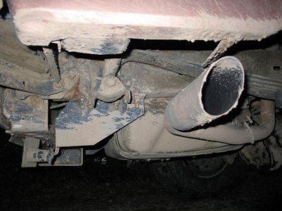

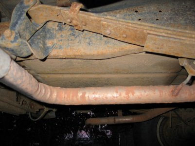

yea i'm kinda with 92 on this. I cant see a benifit to put the smaller tank in other than that you already have it in hand.
I just happen to have a bronco & a F150 in my driveway and have thought about the swap for years and years. It gives you sooo much better departure angle. And i'm tired of banging my gas tank on rocks and stumps.
I would go to autozone/advance/napa and ask to look at a F150 sending unit from the same year as your bronco and see if the wiring is the same.
Here's a couple pics of what is so good about the swap.
