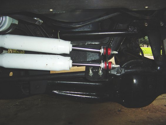

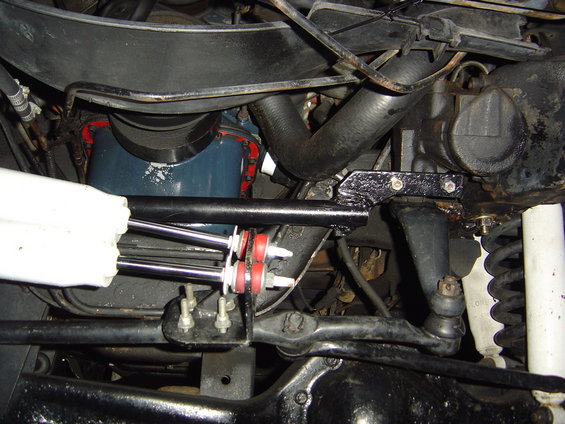

Gacknar did build & installed the bar.
"1/4" angle bolted on with the two bolts you see facing you for the pass side (Drivers side beam) drop bracket, with a gusset welded in it between the bolts. The plate that is clamped to the box is also 3/8", the tube is just something my neighbor had laying around.
Please note, the steering stabilizers have been removed for fabrication, but will be reinstalled later. Thats what the brackets are with nothing on them.
This is from the ground looking up. Are you seeing the triangle?
http://www.supermotors.net/getfile/919577/fullsize/dsc06241.jpg
It works.

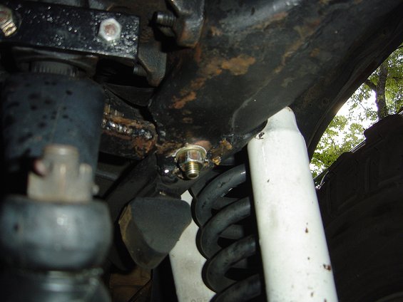

Replaced the loose rivet with a 9/16" bolt per the TSB from Ford.
Between that and the brace there is no movement, of any kind, anywhere.
So, getting the rivet out was a total pain in the but! Grinding the head off was easy, but it just would not knock out. I ended up having to drill three increasingly larger holes all the way through it before it finally knocked out.
Next step was to drill out the hole to 9/16ths"
(Took me a half day to find a drill bit that size)
Next you have to finagle the bolt in from the closed off side of the frame. I ended up pulling it through with a piece of fishing line and working it into a vertical position with a ***** driver, then lightly tapping the head until enough of it was through the hole to pull it through.
Then, if you get everything just right you can just barely get a box end wrench in there to hold the head of the 9/16" bolt wile you tighten the nut down to 140ft/lb. Tada! You have replaced your loose rivet with a 9/16" bolt per Fords TSB.
