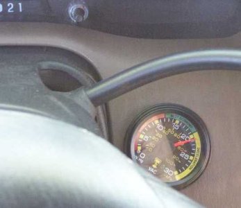

The brake booster vac line is where most insert a T fitting for a vac gauge hook-up; you can leave it in permanently and run the new hose in thru the clutch blank plate and mount the gauge on dash/A Pillar, etc. for an "everyday MPG driving tool" and troubleshooter
Vacuum Gauge Tester Instructions
http://www.fordf150.net/howto/diagnoseengine.php
this is by William T; "...I have a vacuum gauge mounted right in the dash of my truck. I use it to also help determine the load my engine is under while driving, and to estimate fuel economy.
Here is the gauge mounted:..."
http://www.tradervar.com/Vacuum-Pressure%20Tester.pdf
