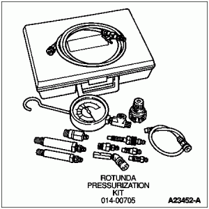

Try a coolant leak test, see following for an overview:
http://www.aa1car.com/library/coolant_leaks.htm
Coolant System Pressure Test by Ford*
For some of the tools/test devices, check with local parts stores for a loan a tool program, with refundable depositl
And if needed a Compression Test*
"If two adjacent cylinders indicate low compression pressures and squirting oil on pistons does not increase compression, cause may be a cylinder head gasket leak between cylinders. Engine oil and/or coolant in cylinders could result from this problem.
Cylinder Leakage Detector*.  When a cylinder produces a low reading, the use of Rotunda Pressurization Kit 014-00705 or equivalent will be helpful in pinpointing the exact cause. The leakage detector is inserted in the spark plug hole, the piston is brought up to top dead center on the compression stroke, and compressed air is admitted.
Once the combustion chamber is pressurized, a special gauge will read the percentage of leakage. Leakage exceeding 20 percent is considered excessive.
While the air pressure is retained in the cylinder, listen for the hiss of escaping air. A leak by the intake valve (6507) will be audible in the throttle body (9E926). A leak by the exhaust valve (6505) can be heard at the tail pipe. Leakage past the rings will be audible at the positive crankcase ventilation (PCV) connection. If air is passing through a blown gasket to an adjacent cylinder, the noise will be evident at the spark plug hole of the cylinder into which the air is leaking. Cracks in the cylinder block (6010), or gasket leakage into the cooling system may be detected by a stream of bubbles in the radiator (8005)."
