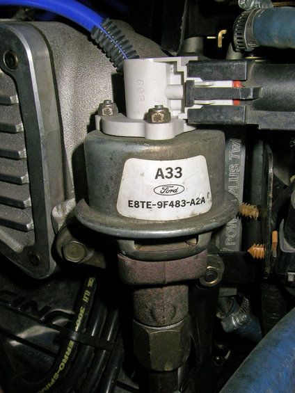

possibly a dirty EGR or bad EVP. Interesting, both the EGR and EVP are newer Motorcraft parts.
First, I checked the mechanical operation of the EGR Valve. I placed a ***** driver under the diaphragm on the metal tab attached to the center pintle shaft being careful not to damage the diaphragm. Pushing upward, the valve opened and closed freely.

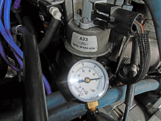

Then I pulled the bottom vacuum line off of the EGR Vacuum Regulator (EVR). Using my handy dandy hand held vacuum tester, I applied vacuum and noted the EGR Valve freely opening, holding vacuum and then closing when vacuum was released.
http://www.supermotors.net/getfile/966963/fullsize/evp-2.jpg
To be sure, I started up the engine and manually operated the EGR Valve finding the engine idle decreased as it should. Then I used my vacuum tester to operate the EGR and again found a normal decreased idle. Finally I ran a KOER test and visually saw the valve operate. Mmmm… If the EGR Valve was old, sticky or showed signs of excess carbon build-up, I would definitely remove it for cleaning. Yet the mechanical function of the valve is fine, so I ruled that out. I moved on to the EVP Sensor...

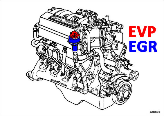

So, what the heck is an EVP Sensor anyway? The EVP is a Linear Potentiometer which uses variable resistance to provide the EEC with a voltage signal indicating the position of the EGR Valve Pintle. It is attached to the top of the EGR with three nuts and has a gasket or O-ring which seals the vacuum chamber of the EGR. Under warm, no-load cruise conditions, the EEC commands the EVR to direct vacuum to the EGR causing it to open a calibrated amount which bypasses exhaust gas back into the intake. The EVP then provides feedback to the EEC allowing it to calculate spark timing, air/fuel ratio, EGR flow adjustment and service code notification.

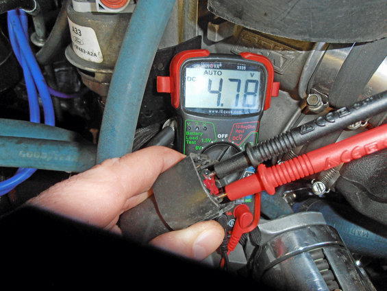

I started by testing for approximately 5v Voltage Reference at the harness connector. Remember this is a Sensor that operates on 5v EEC Reference Voltage, as opposed to an Actuator which operates on 12v Battery Voltage. Unplug the EVP connector. With ignition Key On/Engine Off, place your DVOM on DC Volts and probe the connector at the VREF and EVP terminals. My 4.78v is good.
http://www.supermotors.net/getfile/966967/fullsize/evp-reference-voltage-5v.jpg

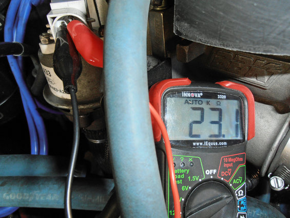

Finally I tested for additional Sensor Resistance at the unplugged EVP Sensor. With your DVOM on Ohms, probe EVP Sensor pins SIG RTN and EVP. You should have greater than 100 ohms. Note that my test shows 23.1K ohms (23,100 ohms) which is not even close to 100 ohms.
http://www.supermotors.net/getfile/966966/fullsize/old-evp-resistance2.jpg

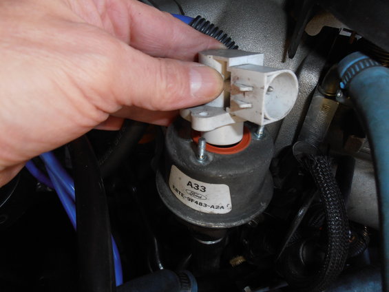

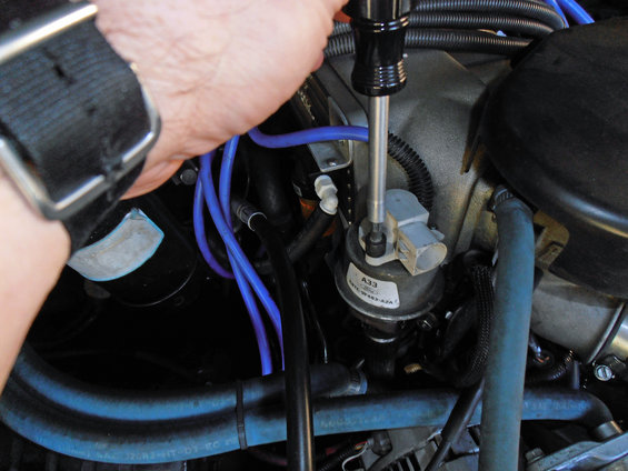

Now we remove the bad sensor and install the good one. To remove the unplugged sensor from the EGR, start by removing the three lock nuts. Be careful that you do not drop or misplace them or they will be gone.
http://www.supermotors.net/getfile/966968/fullsize/evp-3.jpg

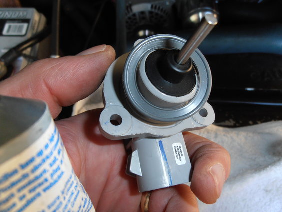

Carefully pry up and remove the EVP sensor from the EGR.
http://www.supermotors.net/getfile/966969/fullsize/evp-4.jpg
http://www.supermotors.net/getfile/966970/fullsize/evp-5.jpg

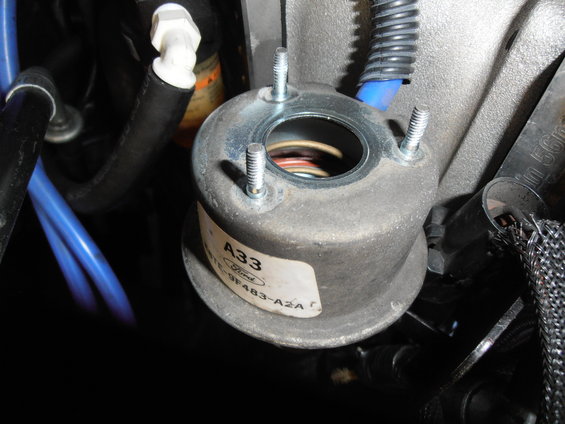

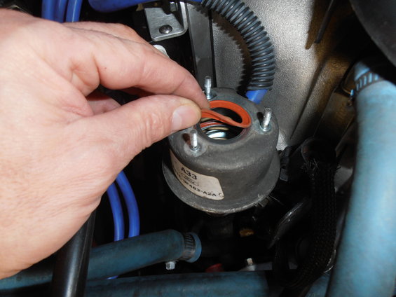

Remove the old gasket. If you cannot find one, that may be the source of your problem!
http://www.supermotors.net/getfile/966971/fullsize/evp-6.jpg

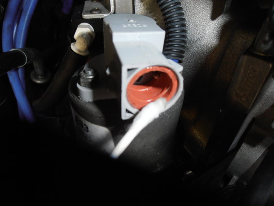

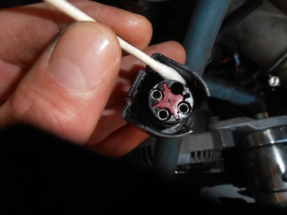

After it is installed, use a Q-tip to lightly coat the weatherproof sensor gasket and the barrel of the connector. This will help keep out moisture and make it easy to remove the connector in the future.
http://www.supermotors.net/getfile/966977/fullsize/evp-11.jpg
http://www.supermotors.net/getfile/966978/fullsize/evp-12.jpg
