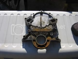

I achieved a measure of success today and I have a few pics to show what I was fussing with.
The first is the bolt, remains of the bolt that is, that I was fussing with.
I just put it on top of the timing cover once I got it out. The threads were rather rusted up but the main sticking was in the bolt passage in the aluminum cover. The threads are at the passage on the left where it was stuck.
I got it out by generous application of penetrating oil and putting a low flame torch on the aluminum cover at the bolt passage then turning the bolt shaft with Vice-Grips. Took some time and a second heating but, it's out. :))
Directly on the opposite side, the same bolt passage is most clogged with corrosion. I will be running a 3/8" drill bit through all of the bolt passages to get rid of the rust accumulations and, I'm putting generous amounts of ant-sieze paste on every bolt going through the cover, pump and into the block so that I won't have to fuss like this again. Next project is to obtain a replacement bolt for that passage on the pump and cover. I'll be getting the highest grade bolt I can find from a hardware store or, I'll get a piece of the strongest all-thread of the appropriate diameter and use nuts and washers to fasten it down. A washer at the cover and two nuts to hold it down and, the bottom nut can be used to turn out the all-thread when I need to remove it.

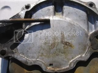

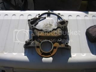

The other fun part I found is this, just to the right of the bolt:
There is a thin crack in the timing cover under where the water pump is mounted. You can see it by the bolt threads to the right and center of the cover. I am going to get some aluma-braze and cover the crack using my torch. I've done stuff like this before for round 20 years so, no worries but, I'm gonna take it easy while I'm doing it.
