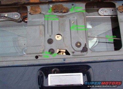

"...If the glass is clear of the shell, but you can't open the t/g, remove the inside access panel & pull these 2 rods inward. Either unclip them from the center mechanism, or pull them like bow strings to release each latch. Make sure the glass isnt so high that it engages the campers groove, or it could break. If it wont come down, unbolt the slides from the glass, or the motor from the regulator to lower the glass..."
Source: by Steve83 (Steve, That dirty old truck) at http://www.supermotors.net/registry/media/160767

The rod running to the Left (down) is the interlock rod that detects the glass being fully down. It is supported by a clip similar to the ones used for the hood cable. The one to the R (up) is the one from the handle. You can see that the mechanism it's attached to is bent. ..." Source: by Steve83
So, the clip may be broken or...
Inspect it after getting lass down and opening the TG

He prob. was yakkin' about that Handle - one reason it's that way now is he or prev. owner(s) tried to open TG while glass was still up a bit.
Check that bell crank & rod starighten it out if bent, as well as anythAng else that looks sssstrange...
