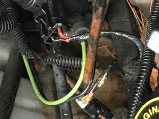

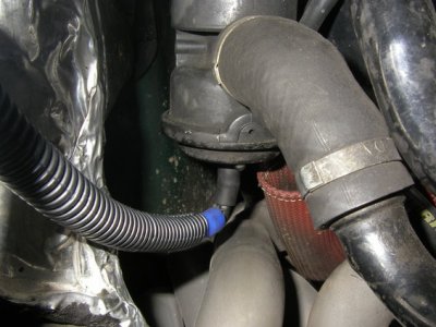

"found one line that runs to no where and is not capped. " I assume it's circled in red. Based on its Location and its a rubber or silicone vacuum hose its attached to  the top port of the Thermactor Air Bypass (TAB) Solenoid (on driver side next to ignition coil, see more info below) and goes directly to the Thermactor Air Bypass (TAB) Valve located on the passenger side near the fire wall.
by SeattleFSB
The fuel rated hose that originates from under the battery and runs for about two feet is from the evaporative emission (EVAP) canister. It is a storage device for fuel vapors that are emitted by the fuel tank in hot soak conditions. When the vehicle is at normal operating conditions the vapors are purged from the EVAP canister. The EVAP canister is controlled by the Canister Purge Solenoid Valve (CanP/CPRV) used in EEC IV that allows the passage of the fuel vapors into the intake manifold where they are mixed with air and burned in the engine. By storing the fuel vapors and purging them into the engine at a later time hydrocarbon emissions are reduced, and fuel efficiency is increased.."
Source: by Ford motorcraftservice.com
Canister Location pic in a 93 by Bbronco311
The activated charcoal inside the canister absorbs gasoline vapor from the fuel tank until the CANP (canister purge) valve opens, allowing manifold vacuum to pull fresh air in thru the dust cap(s), collecting the stored vapors, & drawing them into the engine to be burned.
Any leak in the vacuum lines to or from the canister and CanP valve will result in dirty air entering the intake manifold, and possibly water or other contaminants.
Being virtually a zero-maintenance system, most faults are simple valve failures, hose leaks, or mechanical damage (collision, road debris, etc.).
CANP valve pics in a SeattleFSB
vapor line shown is from canister to throttle body.

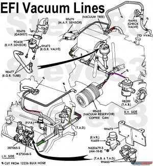

Vacuum Tree atop intake manifold  serves emissions components and vacuum tank; and to HVAC Vacuum tank.

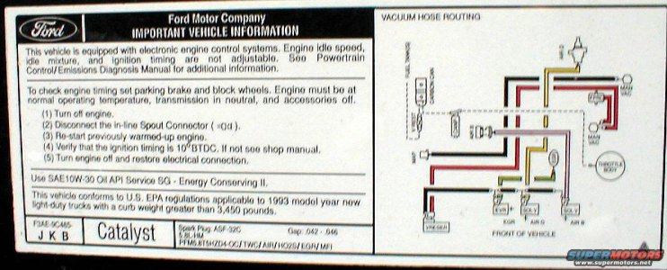

Vacuum Line Routing Diagram for 93
Notes:
FPRC is the Fuel Pressure Regulator on rear of driver side fuel rail described below.
VRESER is emission vacuum reservoir, aka vacuum tank, coffee can that often leaks vacuum due to rust at bottom, etc. SEE BELOW.
EGR is tge EGR Valve Position (EVP) sensor attached to the top of the EGR valve.  SEE BELOW.
Both AIR B (Thermactor Air Bypass Solenoid (TAB, AIRB, AM1))
& AIR D (Thermactor Air Diverter Solenoid (TAD, AIRD, AM2))
are on driver side next to ignition coil
The pink and yellow hoses go to AIB B & AIR B VALVES.  See below
V REST Vapor Valve (Roll-Over) Valve on later year Depictions & Location Diagrams in 5.0, 5.8, 7.5, & 4.9; "...All fuel tank vapor valves make use of a small orifice that tends to allow only vapor and not fuel to pass into the line running forward to the vapor storage canister. This assembly mounts directly to the fuel tank using a rubber seal. Fuel vapors trapped in the sealed fuel tank are vented through the orificed vapor valve assembly in the top of the tank. The vapors leave the valve assembly through a single vapor line and continue to the carbon canister for storage, until they are purged to the engine. The vapor valve assembly mounted on the top of the fuel tank is used to control the flow of fuel vapor entering the fuel tank vapor delivery line which conducts vapor forward to the canister in normal circumstances. If due to extreme conditions, excessive pressure is generated inside the tank, the purge port opens up, allowing fuel vapor to escape to the atmosphere, and stabilizes pressure inside the tank. The valve assembly has a head valve which prevents the fuel tank from overfilling during refueling operation. The valve assembly also has a spring supported float assembly, which prevents liquid fuel from entering the vapor delivery line during severe handling, steep grades or in the event of vehicle rollover. The fuel fill cap is sealed and includes a built-in pressure-vacuum relief valve. Fuel system vacuum relief is provided after 3.5 kPa (0.50 psi) and pressure relief after 11.0 kPa (1.6 psi). Under normal operating conditions, the fill cap operates as a check valve, allowing air to enter the tank as fuel is used, while preventing vapors from escaping the tank through the cap..." by Ford via Steve
See EVR, MAP below.

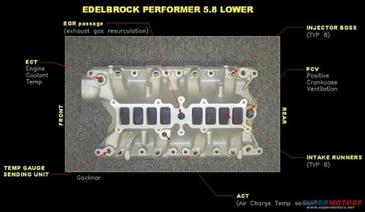

ACT, ECT, PCV, Water Temperature Gauge Sender Location in an Edelbrock Perfomer Lower Intake Manifold Diagram
Source: by GACKNAR

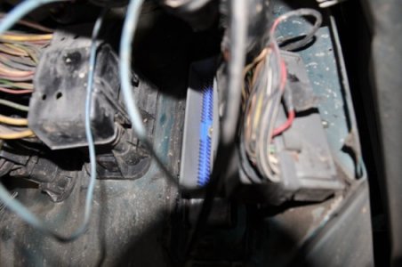

Electronic Engine Control IV (EEC IV, aka Powertrain Control Module (PCM), COMPUTER) Location pic, accessible in engine bay, passenger side.  Remove after loosening and wedging driver side plastic fender liner.
If you have Cruise control, unbolt the cruise control module from the fender for easier access. Lay it aside across the engine to get it out of the way.
EEC Black Connector Bolt is shown above
EEC MODULE IN ABOVE PIC (BLUE TERMINALS SHOWN) by bossind
Earlier years in same location, but can be removed fron drivers kick panel

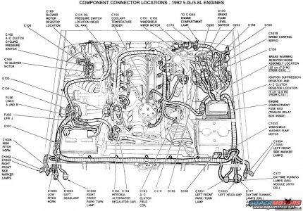

Connector C178 appears to me to be the fuel injector harness.
Diagram by Ford via Jem270
 Top center front of engine, near distributor.
Squirrels set up a nest, chewed the harness, etc. on my 96.
This harness Depiction is difficult to read, but it's the only one I could locate.

"The one on the right (driver side), on the line leading to the condenser, is the high side. You very well may be throwing money away by trying to charge the system without checking for why it is empty in the first place. It's a crap shoot whether it will hold a charge for any length of time or not..." by rla2005 (Randy)
Orifice aka A/C Evaporator Core Orifice. The inlet tube to the A/C evaporator core is fitted with an A/C evaporator core orifice to control refrigerant flow. This A/C evaporator core orifice can be removed from the inlet tube and A/C evaporator core for replacement if it becomes necessary. However, Fixed Orifice Tube Tool D80L-19990-A or equivalent is necessary to prevent breakage when removing the A/C evaporator core orifice. The A/C evaporator core orifice is a restriction between the high and low pressure refrigerant and meters the flow of liquid refrigerant into the A/C evaporator core. The diameter of the orifice within the A/C evaporator core orifice is 1.575mm (0.062 inch). The A/C evaporator core orifice can be identified by the RED body color and white outlet tip.
The A/C evaporator core orifice is located in the evaporator core inlet tube and has filter screens on the inlet and outlet ends of the body. The filter screens act as strainers for the liquid refrigerant flowing through the opening. O-rings on the A/C evaporator core orifice prevent the high pressure liquid refrigerant from bypassing the A/C evaporator core orifice. Adjustment or repairs cannot be made to the A/C evaporator core orifice and it must be replaced as a unit.
Fresh/Outside Recerc Vac Motor is the Recirculation/Fresh Air Control vacuum "motor" & vac line as shown in this
pic by John D.
The vehicle heating system draws outside air into it and distributes this fresh air throughout the passenger compartment in all positions except OFF. If the vehicle is equipped with air conditioning, outside air is distributed throughout the vehicle in all positions except OFF and MAX A/C. In these positions (OFF, MAX A/C) the A/C fresh air inlet door is in the closed position and air within the passenger compartment is recirculated throughout.
MAP aka Manifold Absolute Pressure Sensor operates as a piezoelectric (pressure-sensing) disc. However, rather than generating a voltage, its output is a frequency change. The sensor changes frequency relative to intake manifold vacuum. The sensor frequency increases as vacuum increases. The MAP sensor allows the EEC IV to determine what the engine load is. Its signal affects air/fuel ratio, ignition timing, EGR flow and altitude compensation.
MAP pic (circled) by Jem270
