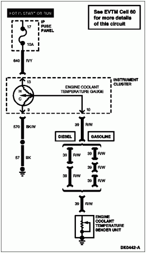

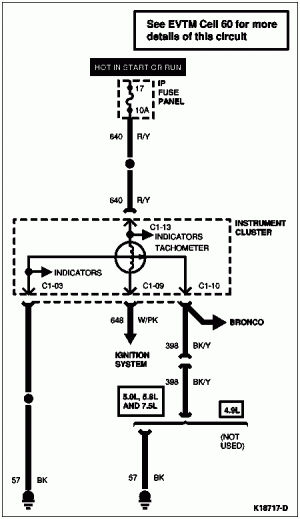

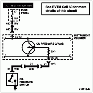

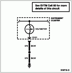

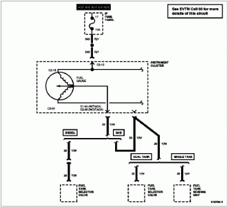

Yo 93,
The gauges don't travel through nor are controlled by the computer.
The sender's should work on the 408.  On the 408 ensure all ground straps etc are attached to block.
Some of the wiring diagrams:

9 648 (W/PK) Tachometer Input Signal
10 398 (BK/Y) Tachometer Ground (for 8 Cylinder)

8 31 (W/R) Oil Pressure Input

10 39 (R/W) Temperature Input
