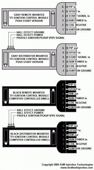

Do I need the TFI with the 3 pins on top or do I need the one with out the upper pins?

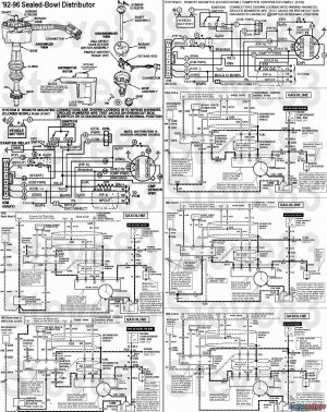

If this is for a 93 Bronco, use DY1075.  Confirm this here.

Yes - REFER to Section 8A for Diagnostics miesk5 Note, we need to find a member here that has access to the 93 EVTM in order to continue the troubleshooting,
miesk5 NOTE; use Motorcraft BLACK CCD Modules in 94-96 Broncos.

"...PART NUMBERS for ICMs; the best way to determine which ICM your vehicle is wired for is to check the wiring of the vehicle. If pin #4 of the module gets a start signal (which should be battery voltage) from the starter circuit, it's a gray "Push Start" system. On the other hand, if pin #4 of the module is wired directly to pin #4 of the PCM, then it's a CCD system. This should be the same for either the distributor mount or remote mount ICM.If pin #4 of the module is wired directly to pin #4 of the PCM, simply change to a Black CCD TFI ICM and your CEL should go away (unless you have other problems as well). I recommend a Motorcraft DY1077...."

miesk5 NOTE; use BLACK CCD Modules Only in 94-96 Broncos

I contacted Brian about my 212 code and he said that was a common problem with the Gray TFI and the new ECU that are from a 1995 MAF 5.0 F-150. He sent me a wire and some instructions, I found a Black TFI from a Ford dealer in CA, (nos part) and shortly after the part arrived I installed the new TFI.
Also found a few other loose wires and patched them up. Since installing the new Black TFI I havn't had the 211 code.
