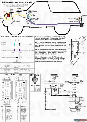

Hi, I am trying to find a thread from earlier today. Someone Posted that they got so frustrated they hot wired the rear window to the car battery. I am right at that point. I have to travel 1800 miles, and need to access the back daily, and I am out of time! Can anyone help me figure out how to do this? Thanks, Nancy

Seems like their is power always going to the rear. You can use the key in the tailgate to activate the switch. If your trying to use the dash switch with out putting a key in the ignition you'll need to jump the AUX power wire in the ignition switch.

Remove the access panel from inside the tailgate. Run test wires from cordless tool battery, another battery or battery charger directly to the window motor connector. Yellow with small red striped (Red/Yellow) & red with small yellow stripe (Yellow/Red) wires coming right out of the motor. To lower the window, it should be positive to Red/Yellow, & negative to Yellow/Red. Be ready for the window to move, keep hands & wires clear. If it tries to go the wrong way, reverse the wires.tgmotorwiring.jpg
http://www.supermotors.net/getfile/692844/original/tgmotorwiring.jpg
