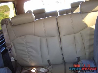

so far, i have seen someone use 2 sets of tahoe 3rd row seats (one as a 2nd, and one as a 3rd row) and i think those will fit the bill (but maybe not the budget)

.hoe Buckets in an 83; "...I put a 3rd row in my 86 Bronco. I used two 3rd row seats from 2004 tahoes. They go in and come back out in a matter of minutes or they can just fold down. The best thing is that they have shoulder belts for when the top is off..."

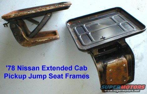

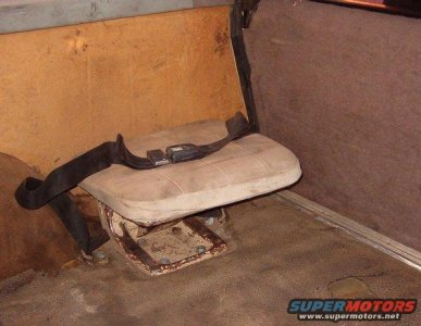

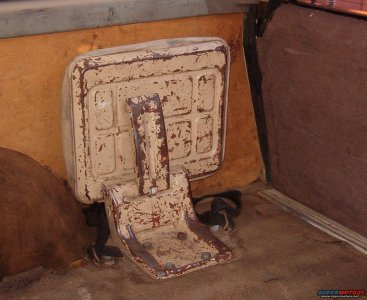

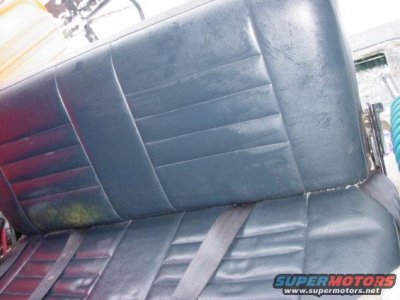

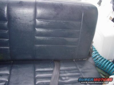

Jump Seat pics; "...I've seen at least 3 Broncos (not including mine) with these same seats in them (with belts), so I assume it was a rare factory or dealer option. Then I found them in an extended-cab Datsun pickup, and I know those were factory because of how they were mounted, and the backrests. know it would be fairly easy & very safe to turn the back seat around, but IDK if another Bronco back seat would fit as a 3rd-row. Remember that the passengers need some legroom, so measure from the back of the FRONT seats to the back of the BACK seat, and that's how much room you'd need for another fullsize row. You could afford to lose some of the legroom, but not much. Whatever you put back there: take a look under your bed to see how the original seats are mounted (i.e., how the floor is reinforced), and do something similar for your new seats. Those jump seat bases are large enough that I only had to put thick fender washers underneath for them & their belts..."
I'm still not sure if these were a factory option, a dealer option, or an aftermarket option. I've only seen 2 other FSBs with them, and both were '80-86. I know they were original equipment on Datsun/Nissan king cabs, and I know these had upholstery that matched the rest of the Bronco that I took them out of, but that might have been custom-made. What's on them now is.
They're surprsingly comfortable & secure, according to everyone who has ridden in them. Even the ones who rode here during some ROUGH off-roading.
I originally sandblasted & fiberglassed them because the bases were horribly rusted, and then I painted them. But all the tool boxes & cargo I've hauled wore a lot of the paint off.
The biggest DISadvantages to these are that I can't use an aftermarket molded cargo area mat, or the stock '92-96 bedwall panels because of their pockets.

ok, i got rolling on this
the plan is to get two sets of seats from the yukon/tahoe truck and replace the stock back bench with a 50/50 split, and put a full bench in as a third row
i picked up the 50/50 split for $100 bucks, and will keep an eye out for the bench
for now, im going to bank on both using the same mounting points and try to figure out how to mount the 50/50 in as a 3rd row
im thinking door strikers is the answer
they should give me the height i need and be sturdy enough to hold the seats down, as well we be easily obtainable, not break the bank and not look cobbled together

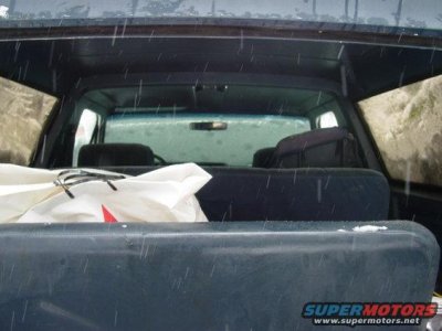

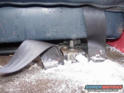

got the third row in
if it ever stop raining ill toss up some pics
i decided to use square U bolts instead of door strikers, because it was one less thing to buy
it all went pretty easy once i dropped the gas tank to get at the nuts in the back
