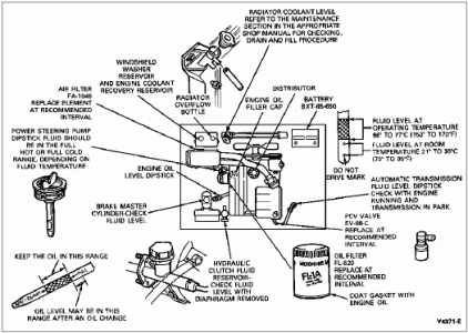

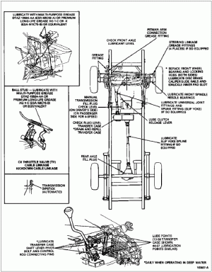

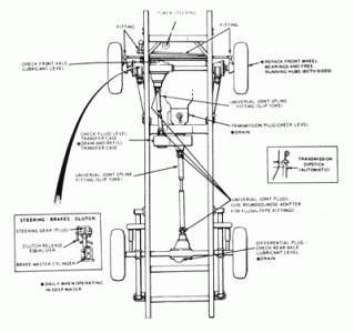

Following by Ford:
"Important lubrication points for typical chassis and engines are shown in the following illustrations. Vehicles with optional equipment may have slightly different or additional lubrication points. When special equipment or accessories are installed on the vehicle, consult the manufacturer's literature for lubrication procedures."
Service Points — ChassisF-150, F-250, F-350 4x4 and Bronco
5.0L and 5.8L Engines, F-Series and Bronco
