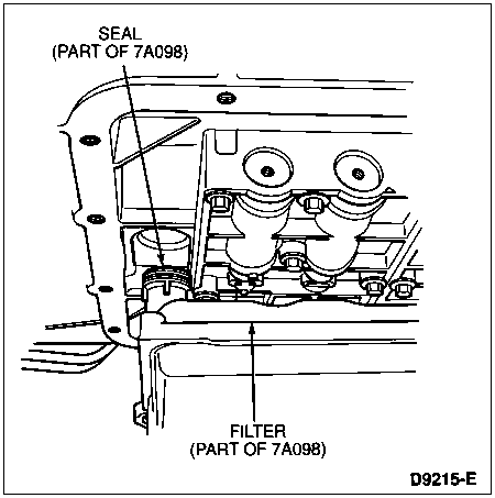

Or could be the filter's Seal.
NOTE: Seal may remain in bore when filter assembly is removed, just like an oil filter.
Remove filter assembly and seal by carefully pulling and rotating filter as necessary. Discard filter assembly and seal.
http://www.diesel-dave.com/vehic/manual/stj/images/d9215e.gif
http://www.diesel-dave.com/vehic/manual/stj/stj71a33.htm
CAUTION: Use care not to scratch or damage aluminum pump bore.
If seal remains in bore, carefully remove using a screwdriver.
NOTE: Do not reuse old filter assembly or seal.
Install new filter assembly and seal by lubricating seal with transmission fluid and pressing filter into place.
Filter, Internal, Grommet Warning; "...When ever you go to change your trans filter, Always make sure to pull out the little round rubber do hicky thingamabob. Lets call it a gromit or a seal? Theres this part of the trans filter that is inserted into the trans (a round tube that goes up into this hole ); Now the tube has a gasket of sorts that wraps around the tube ( kinda like a wide O-ring )It form a seal between the tube and the hole it goes in. Well what ended up killing my trans was that fact that the last guy that changed the trans filter didnt notice that this o-ring thing (gromit Or what ever) did'nt come out with the filter it stayed in the hole! He left it in there; & installed the new filter witch had its preinstalled gromit already; So what he did, is he (unknowingly) stacked two gromits on top of each other, Witch did not let the filters tube fit as it should. It was starving itself for fluid!! It was sucking air as well as tranny fluid! (in other words not working right) ..."
Source: by BlancoBronco (Cam C , Project BLANCO)
