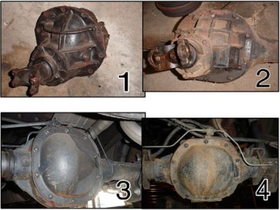

Information, History, ID, pics, etc.
Source: by Kenneth C at Bad Shoe Productions badshoeproductions.com
Photo 1 - The 9” rear ends have a removable “hog-head” center carrier and is about 10” from the bottom to the top stud. The 9” was introduced in 1957 and ran to mid 80's.
Photo 2 - The 8" rear was use from the 60's to the late 70's, top to bottom stud is about 9".
Photo 3 - 8.8” rear’s have a ten bolt inspection plate on the back that’s about 10” from the center of the top bolt to the bottom bolt center. The 8.8” first saw service in the 79 Crown Vic. and in 1980 for the F100/150.
Photo 4 - The 7.5” rear was first put in the 78 Fairmont. It also has a ten bolt cover but measures about 9” from top to bottom bolt.
