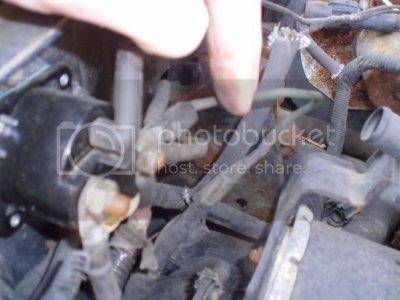

So I was checking the blue/white wire coming out of the positive side of the coil. It was cut intentionally by the previous owner. and the noise connector with a blue/white wire was also cut. Coming from the ICM the blue/white wire (that originally went to the noise connector) was connected to the wire that had connected the positive side of the coil at one time. It looked to me that the the positive connection and the noise connector were completely bypassed. This apparently never caused any problems before because it ran fine. I'm wondering though if the fusible link at the end of all this blue/white wire mess happens to be burned out. I don't know where that fusible link is though.

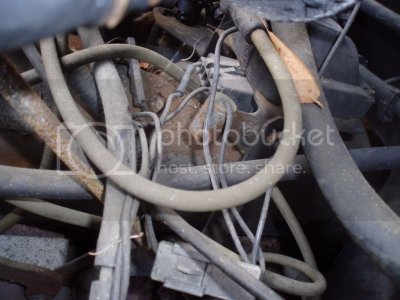

Wow. I'm really scratching my head now. I traced the white/blue wire all the way back to where it starts. Saw no fusible link whatsoever, the diagram shows a fusible link. So I decided to check the continuity, at least that would tell me if it was broken somewhere. It is fine. Where does the coil get it's power from? Does it come out of the ICM? maybe it's one of the two green/yellow wires that go into the + side? If so, those wires come from the ICM. Hmmmm...

I have that same diagram. Fuse link D is the one I was looking for when I was tracing the white/blue wire. But I checked the whole length of the wire and found no fuse link. Like I said I checked the wire for continuity and it was good from start to finish.
So last night around dark I decided (not sure if it was a good idea) to put the white/blue wire from the + side of the coil directly to the + side of the battery. Turned the key and she fired right up. So at least I know the problem is no juice to the coil. I really doubt it would be safe to leave it that way so I still wanna figure out how to re-wire it the way it is intended to be.

I posted it so we can all talk and see the same thing, the other way we were only able to read what you read and had no real idea what you were talking about. Now we can see without a doubt. When I look at the wire I see that it branches off from the coil to the tfi modile and to the noise capacitor thingy. The other end of the wire goes to the fusable link. When you trace it i'm wondering if you follow it and end up at those other places. Have you probed the wire to see if it has power before the coil? I am thinking where the butcher cut the wire and twisted it together is causing a crappy connection. I would start at the hack job and put proper connections in place. If all else fails you can wire it to a keyed power source til you can fix it properly. Dont wire it to a constant hot wire, it should be keyed.
