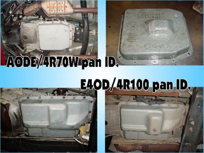

According to the chart, the F0TP-7006-CB is the E40D froma 90/91 Bronco? From the pic of the whole tranny, it certainly does look like the E40D. not a C6. You can also go by the pan shape and number of bolts in the pan. Think there's 20 bolts, may find a pic or have Blade confirm that, JSM84

Heres a C6 trans pan, unless it looks like that with 17 bolts it aint a C6, All i know is the E4OD has 20 bolts, an AOD has a squarish pan that narrows at one end with 14 bolts.
