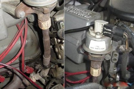

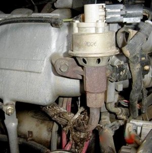

EGR - They use different exhaust tubes to connect the EGR to the exhaust. The 5.0L gets exhaust from the lower intake, while the 5.8L gets exhaust from the passanger exhaust manifold.
Below is a 5.0L EGR:
Below is a 5.8L EGR:
