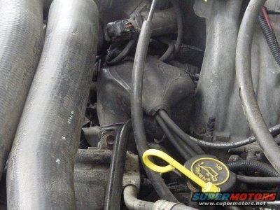

up. Who here has the original rubber boot that covers the distributor? I do!! Keep the wires sprayed with silicone to keep them waterproof
