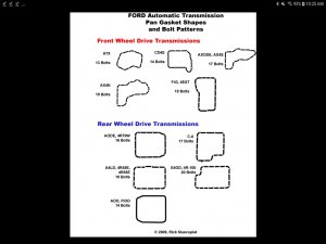

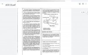

Yo Capt,
Which transmission do you have?
89 5.0 has AOD
89 5.8 has C6
AOD:
C6;
