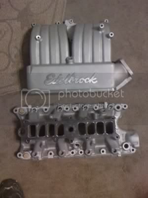

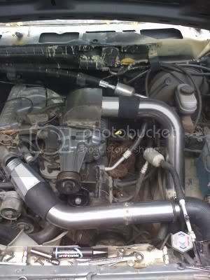

Here are 2 pics
if this site won't allow Image to post; see it here @
http://i220.photobucket.com/albums/dd305/justinjcox/Tubes.jpg
or see it @
http://i220.photobucket.com/albums/dd305/justinjcox/Broncointake.jpg
New Edelbrock intake
or http://i220.photobucket.com/albums/dd305/justinjcox/Broncoblower6.jpg
Unfortunately the 10 pages are filled w/useless comments by some folks there; a Mod should have deleted the idiot posts so that Boostcrazy99 would have a cleaner write-up and spent less time answering some Qs that he was in process of answering later as he progressed through the build-up.
Here is his result;
"Factory crank ratings are:
190hp/270tq
Assuming a 10% loss in power due to age and milage, that would put me at:
171hp/243tq Crank
114hp/156tq Rear Wheel
That is a 33% driveline loss!
So with the new rear wheel #'s just add 33% to the new #'s.
154hp/230tq Supercharged rear wheel #'s
205hp/306tq Supercharged Crank shaft #'s
These #'s might look low but you have to remember that was with a 15:0 AFR. I need to get it down to 11.8:0 Once I get more fuel in it will make more power. Sorry I haven't been on here in a while, I was working the SEMA show in Las Vegas..."
