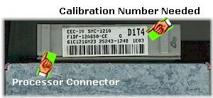

Enter applicable info (need to know your Calibration number off of your PCM or driver B pillar sticker)
In this example D1T4 is the required number.​
