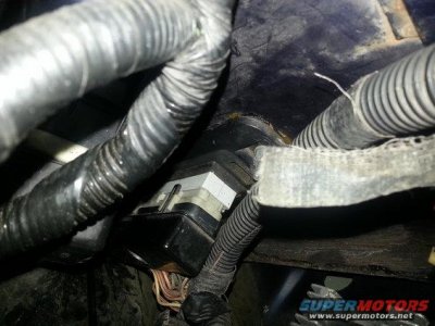

Starter Relay pic in an 88
Source: by Jem270
big red cable is from battery +
large black cable on othe side goes to starter
small wire at top is from ign switch via neutral safety switch .  It has  a pull off, push on connector.  Should be blue/white.

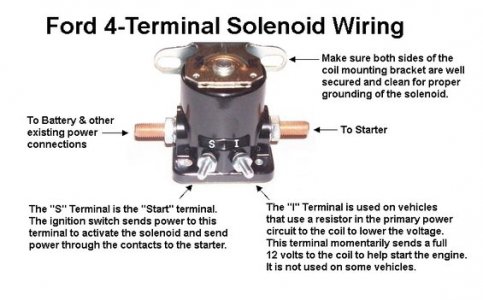

 86 starter relay wiring diagran @
1986\FM\WRFM86BRON015b
small wire at "S" post on the starter relay is from ign switch via neutral safety switch .  It has  a pull off, push on connector.  Should be red/light blue stripe.
