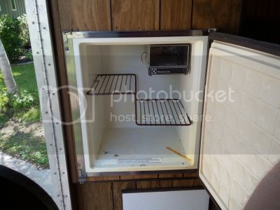

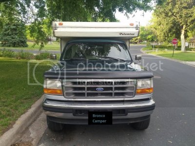

Hello, My name is Jeff and I have always had a Bronco or K5 blazer since I could drive. I have been planning to build a custom one off fiberglass pop up camper for a few year now and was going to start this summer. I was on craigslist the other day though and scored on a pop up camper for only 50 bucks from this 85 year old guy who was the original owner. The camper came with everything from the tie downs to the original paper work from 1983. This thing is in great condition for the age and everything works like new. I have it mounted on the truck to test fit. I'm working on making a custom B piller panel to make a pass-through which will move it forward 6 inches so the rear of the camper lines up to the end of the tailgate so it doesnt have as much over hang and a better center of gravity. Im also going to remodel the interior starting with painting the wood paneling new wood flooring and reupholstering everything.

I just talked to a guy on craigslist with a stock topper im picking up in the next few days.  Im going to chop up the stock topper and mold it to the camper to seal the B piller to the camper and fill the gap on the bed rails.  This will also allow me to use the stock mounting bolts to mount the camper vs any of the normal camper tie downs.  Im also going to make a custom pass-through to access the camper from the front seats.

The camper owner really took care of it. Looks like the commonly missing items are still intact, such as knobs, pulls, etc.

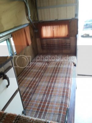

Sounds good ill fill out the signature section now.  This camper is so complete it even has all the owners manuals and warrenty cards and everything works like new.  Even the power converter has 3 110v plug in's and came with the adpater to run off the truck battery.  I'm replaceing the electrical system though and adding a few trojan T-105's solar panels and charge controller.

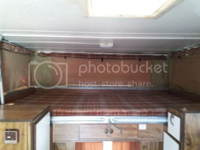

miesk5 thanks for the post with the B pillar mod info.  I'm going to start modding mine soon as the rain quits... Lets hope in the next 2-3 days.  Get this thing molded to the truck and pass-through cut out... then im gutting the interior and rebuilding it from scratch :/  Kinda bitter sweet with how nice the original interior looks but the laminate is starting to peel and the wood paneling and dark upholstery just doesnt work for me.  I'm going to try and reuse the fridge, heater, stove and sink. I just want to make new cabinets out of quality wood, hard wood flooring, changing out the insulation for closed cell foam, fiberglass paneling on the walls and all new upholstery.

I checked that link out and just like most of the internet pictures and post they dont show much on how these things are mounted to the truck.  I believe the campers that where made for these trucks like in the link dont have a floor like normal truck bed campers and just mount straight to the bed rails.  I got a good idea how im going to mount the camper while keeping the original floor for storing the camper off the truck.
