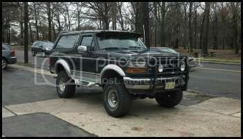

I am Dave from New Jersey and I just purchased a 96 bronco XLT with a 302 in it. The first car I ever owned was a 83 bronco with a 351 in it back in 96 when I was a senior in HS. I need to install an engine in it when I can since the one in it is siezed. Can the 351 bolt right up to the same trans
Welcome to the forums! You have one nice Bronco, If it goes missing don't look my way :-"
