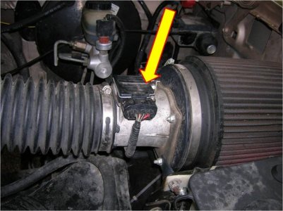

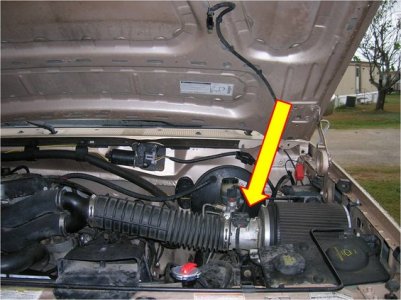

ok i still cant find this maf sensor on my 95 bronco full size with a 5.8 . i removed the air intake hoses that connect to the throttle body and removed the air filter and looked in the filter box housing . anyone know where this thing may be

Are you sure your truck has one? Not all '95s were equiped with MAF systems. If you have it, it is located inside the airtube right where it connects to the air filter box. Here are some photos of mine. (I have a K&N filter in place of the air box, but the rest is the same)
Here is a closer shot:
If you look inside the metal housing, the actual sensor runs top to bottom in the tube and senses how much air is flowing past it by measuring how much energy is required to heat up a wire suspended in the airstream.

thanks roadkill well now i know for sure i do not have one. i was going crazy trying to find this sensorl. what does it tell me about the engine since i dont have a maf sensor ? did they replace the sensor with a different type of sensor to determine the air flow going into the throttle body? .thanks .your ride is really cool

It's nothing to be alarmed about. It just means your truck uses "Speed Density". I posted a more detailed reply in your other post titled "Why not?" before I read this one. You can find lots more detailed information about both systems just by googling the terms "MAF" and "Speed Density".
