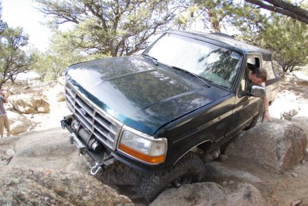

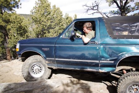

I agree with Steve. I have been wheeling the Bronco for a long time with no lift. Just put the Detroit in the rear this year and like it but I was able to go almost everywhere I wanted to without it. For example--
