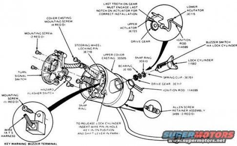

Turn Signal Switch Replacement & Repair Info w/Tilt Wheel in a 90; similar to 80-91
  • Unscrew/remove the turn signal/tilt lever, pull the steering wheel (you may need a steering wheel puller) and remove the turn signal switch screws.
  • The turn signal switch harness is a very tight fit through the steering column to the connector under the dash, especially with the harness connector attached.
  • First, look closely at the new signal harness connector at the end of the new harness and write down the wire color locations. Ensure that the new connector is the same as the old one.
  • Locate the base of the signal harness connector under the dash by pulling on the top from the signal switch. Be sure that you locate the correct wires!!!
  • Then I just cut the wires on the old signal cam harness before the old connector and pulled it out from the top of the column.
  • Un-pin the wires from the new connector and tape/feed the wires back down through the column.
  • Re-pin the new connector, referencing the old one, and reconnect to the main harness.
  • Re-install the turn signal switch, steering wheel and turn signal lever and your done.
I highly recommend a new Ford Turn Signal Switch & Harness for longevity and especially "feel". (Aftermarket Turn Signal Switches break easily and feel "funny").
Source: by Seattle FSB (SeattleFSB

yo M,
Sorry; that is Ford's name for turn signal switch
on clumn
looks like this
